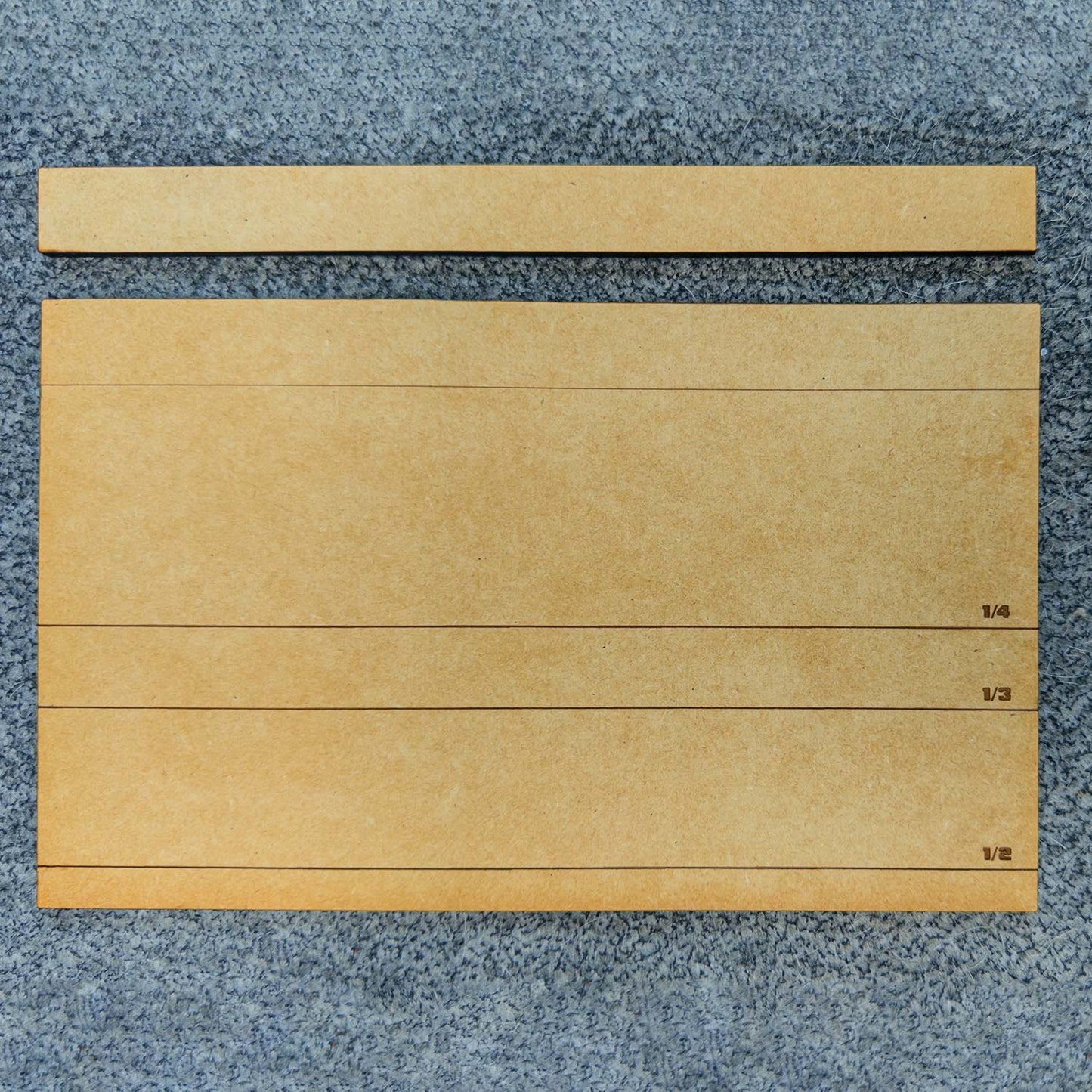

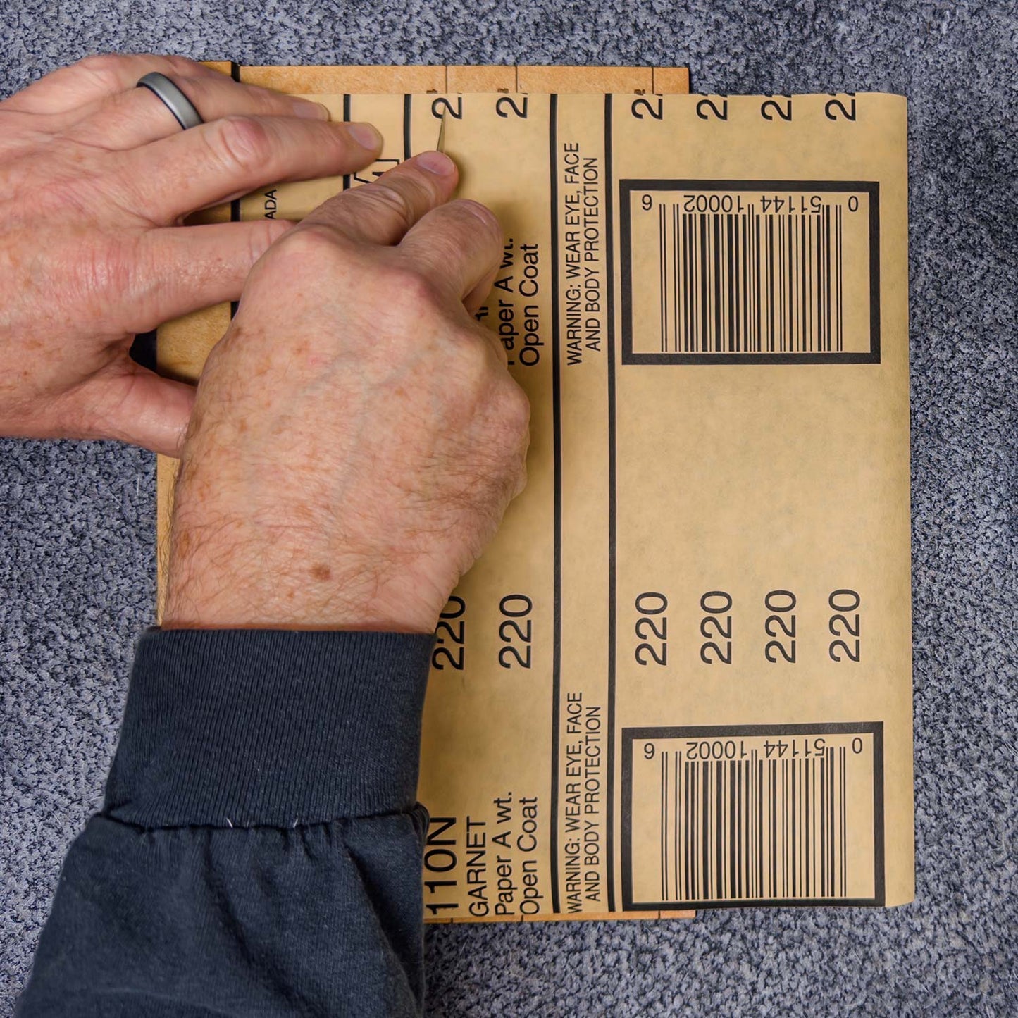

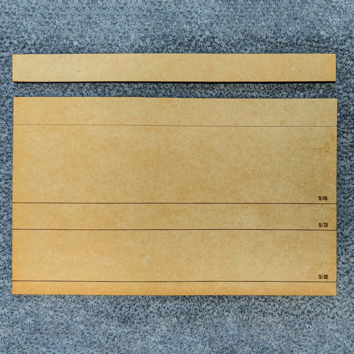

This guide is a simple way to cut down your sandpaper to fit standard sanders and sanding blocks. It’s designed to put your full sheet (9x11) on the board. Just butt it up against the top block, and use a utility knife to cut through at the cut guides engraved in the board. There are guides for ¼ sheet, 1/3 sheet, and ½ sheet.

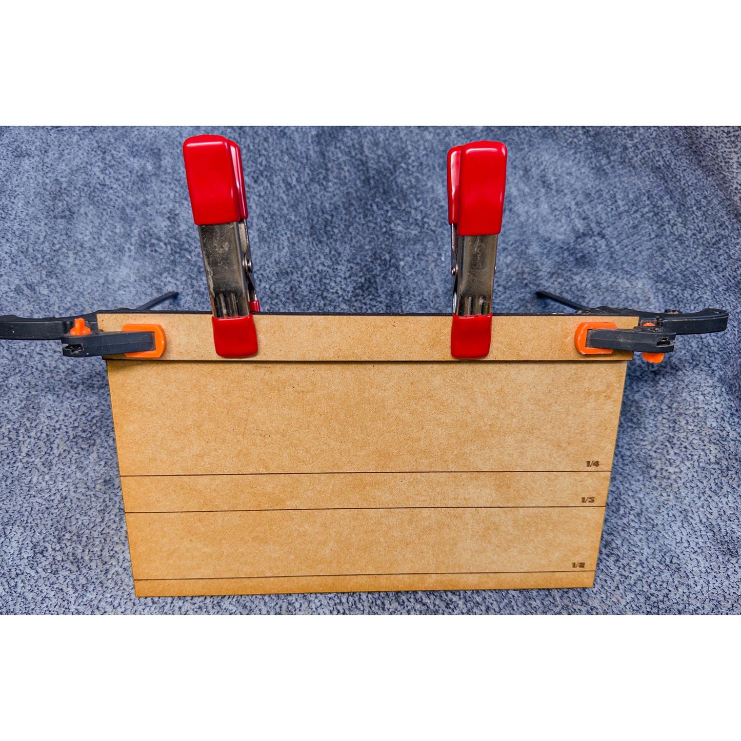

0.5 x 11.5 x 7 in
Clamp
